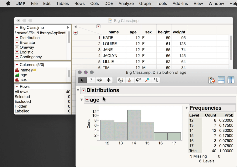

jules
Re: Solution to sorting bar charts single by category count
Hi @rossjason,
As @Audrey_Shull mentioned, improvements in JMP 13 make this easier. But, there is perhaps an easier way in JMP 12 and earlier you might be interested to know about. Graph Builder (like all platforms in JMP) respect the Value Ordering property set for a column. So, if you had an easy way to set the value ordering property for a variable based on counts you could make your plot in Graph Builder without having to worry about sorting by count. It turns out there is that exact capability from Analyze > Distribution. First, launch Analyze > Distribution with whatever variable will be your X axis in your final plot. Then, go to the Red Triangle > Order By > Count Descending (or Ascending). Return to the Red Triangle > Save > Value Ordering. This will set the value ordering property for that column, and now Graph Builder will automatically arrange your X levels honoring the count.
I hope this helps!
@jules
