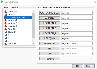

I made a script to line up columns to proper names and the format showed up nice like this:
Then I tried to add a check box to the right hand side and now the column name boxes are different widths.
Any input on what I need to change to get it to look like the first image(all the boxes the same size) just with the check boxes on the end of each row?

I would most likely try doing this with Line Up Box. Something like:
Names Default To Here(1);
FC=1;
SN=1;
nw = New Window( "Launch Dialog",
	<<Modal,
	V List Box(
		Align( "right" ),
		H List Box(
			Panel Box( "Select Columns",
				clb = ColListBox( dt, all, /*<<Set Data Type( "Numeric" )*/grouped )
			Panel Box( "Cast Selected Columns into Roles",
				Lineup box(N Col(3),
					Button Box( "PCC_FEATURE_CODE", clbFC << Append( clb << Get Selected )),
					clbFC = Col List Box(MinItems( fc ), MaxItems( 1 ), nlines( 1 )),
					cbfc = Check Box( "needed", 1, <<set(1,1)),
					Button Box( "SERIALNO", clbSN << Append( clb << Get Selected )),
					clbSN = Col List Box( MinItems( sn ), MaxItems( 1 ), nlines( 1 )),
					cbsn = Check Box( "needed", 1,<<set(1,1))
-Jarmo
