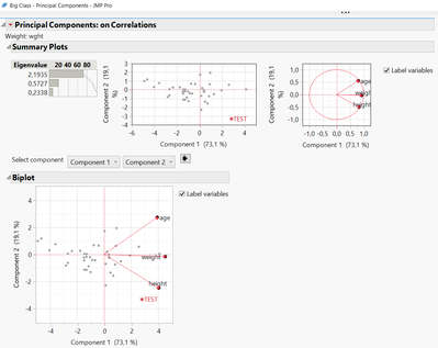

Hi @TCM , I first tried to work with Hide/Exclude, but didn't work, because excluded rows have not shown in the Biplot, too.
Then I introduced a new column "wght", that is the weight of the row for the PCA analysis. I added one row to the Big Class Datatable, gave it marker and color, and performed PCA Analysis. And this gave the plot you may want.
You can add as many rows you want, give it a wght=0, they will not contribute to the model. But they will be shown in the plot (give it another color/marker as well to be able to identify it). By performing the PCA analysis, you will get your new plot then.
See Screenshot and table for the example.

Brilliant!  Thank you so much!
