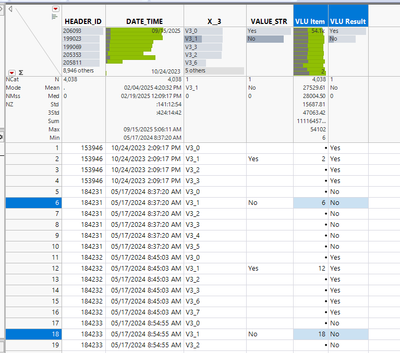

So I have been using a formula that works in the same way as vlookup in excel but I have now discovered that it does not work on larger data tables as it basically bogs down and kills JMP.
Attached is a sample data table and where I have split out the two functions that I had combined which works as expected:
VLU Item
VLU Result
If I were to take the formula from the "VLU Item" column and put it into the VLU Results formula this will cause the death spiral.  Having the columns be two separate ones is not a deal breaker but it would be cleaner if I could do it in one formula.

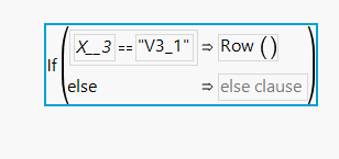

The issue is caused by the
Col Maximum(if (String comparison ))
Besides abandoning the idea of a column formula, other workarounds for  JMP < 19 are:
  1. DON'T use a string comparison, convert the string to a number:
    :VALUE_STR[Col Maximum( If( :X__3 == 3.1, Row(), . ), :HEADER_ID )]
    Tips and Tricks - best practice with JMP/JSL
  2. ... or use Contains()
    :VALUE_STR[Col Maximum( If( contains(:X__3 , "V3_1"), Row(), . ), :HEADER_ID )]
  3. DON'T use col max() to "distribute" a single value in groups
     ... col median() is much faster:
    :VALUE_STR[Col Median( If( :X__3 == "V3_1", Row(), . ), :HEADER_ID )]

I like your analogy better.  Also, your suggestion for use COLMEDIAN() worked perfectly.  Crazy that the two functions have such difference performances.  Just one more reason to look forward to getting 19 installed soon.
