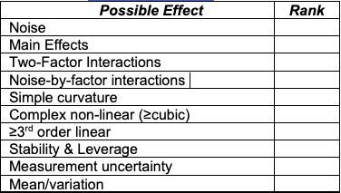

  5. What are the prioritized effects (see below) you want to estimate?
  6. Are higher order effects suspected/predicted (e.g., interactions, curvature)?
  • What is the desired resolution? (What effects do you want to estimate/separate?)
  • What order polynomial is necessary?
 IMHO, the type of factor has less to do with experiment selection and more to do with how the experiment should be analyzed (what model or analysis platform)

3rd After screening phase. Since I know already the factors that are significant. I can use Augment Design to add higher order effects like 2-factor interaction and/or quadratic for process factors and 3-order effects (3-factor interaction and cubic) for mixture/formulation.
If I know already the significant factors. I can skip the screening phase and will go straight-ahead adding 2-factor interaction, quadratic effects for process factors and 3rd-order effects for mixture/formulation.
Please enlighten me about leverage/stability, measurement uncertainty, and mean/variation?
Thank you very much :)

I believe you should always have a strategy to handle noise.  Holding it constant is a terrible idea as it narrows the inference space.  The dilemma is always how to increase the inference space without negatively affecting the precision of the design. These strategies include the ones I listed.  If you do not understand them, you should seek to learn about them.  Split-plots have many uses (hard to change factors is only one of those purposes).  I recommend you read "Split-plot designs for robust product experimentation" by Box and Jones.
I would suggest mixture designs for formulations (not augmented designs).
If you have >15 factors, you might want to get an idea of which components to further study.  You can do this with nested and systematic sampling plans to determine this leverage.
If you don't understand measurement variability, you should do this before experimentation (or nest this component within treatment) .
If your problem is one of variation (instead of the mean), then you need to get an estimate of variability for each treatment.  This can be accomplished by collecting multiple "data points" (repeated measures).  For example if you have within part or within batch variability, you need multiple measures of the within part or within batch and then use a summary statistic to estimate the variation.  This statistic becomes one of the response variables to model.
