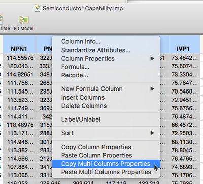

@Jeff_Perkinson: That's the option I was looking for but it doesn't exist in the Windows 14.1 version.  Have a look at my attached image, those are the only options available to me.  I was sure I'd seen that option there in the past.
txnelson
Re: Simple method to copy multiple column properties to a new data table?
The Copy Multi Column Properties isn't showing up, because the column you are referencing in your right click, does not have any column properties to copy
Change to a column that has the properties you want to copy, and the option will show up
