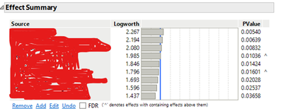

I have made a custom DOE and have been analysing my data first step-wise to identify important effects then standard least square to find significant effects. I could see the following significant effects:

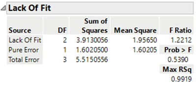

I then checked the Lack of fit, which was also ok

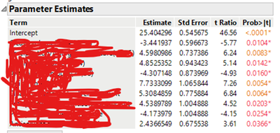

I then looked further down through the parameter estimates and saw a lot of red values for the parameter estimates. What does this mean for my model? Is it no longer significant even though effect summary and lack of fit says it is?

The red highlight represents p-values below 0.05 and greater than 0.01
The orange highlight represents p-values below 0.01
All the parameters listed in the last table are significant.

It is known as 'conditional formatting.' You can find it by selecting File > Preferences (Windows) or JMP > Settings (Mac). Select the Reports group on the left.
You can turn this formatting on or off. You can modify the rules and formats. You can add your own formats.

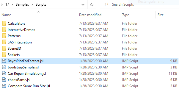

The Bayes Plot that @statman referred to is available in the Fit Least Squares platform. It implements the first version published by George Box, which only considered the main effects. Box later updated the method to include higher-order terms. We provide the updated plot as a JMP script in the Samples/Scripts folder here (Windows):
I also attached the script to my reply.
