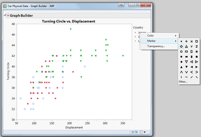

pmroz
Re: Is it possible to change the marker theme in graph builder?
You can right click on an entry in the legend and select Marker >

jmptastic
Level I
Thanks, but that will not change the overall marker theme. Lets say I wanted to change the theme to alphanumeric, how would I do this?
