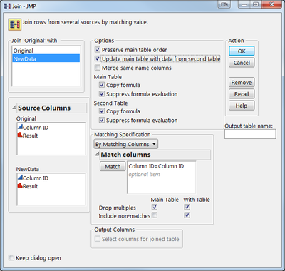

When performing a join you can avoid creating a new table by using the  option "update the main table with data from second table".
-Dave
pmroz
Re: Appending non-duplicate (single column ID) rows to a main table without creating a new table?
I tried using the update main table option but it still creates a new table.
Data Table( "Original" ) << Join(
     With( Data Table( "NewData" ) ),
     Update,
     By Matching Columns( :Column ID = :Column ID ),
     Drop multiples( 1, 1 ),
     Name( "Include non-matches" )(0, 1),
     Preserve main table order( 1 )
