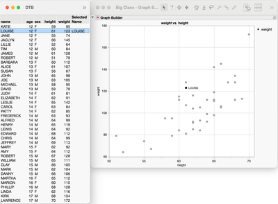

In Graph Builder, I want to show a data label (not a hover label) for selected rows only. As a demo, I tried the following code:
Names Default To Here( 1 );
Try(
	Show( dt:Selected Name ),
	dt << New Column( "Selected Name",
		Character,
		Set Formula( If( Selected( Row State( Row() ) ) == 1, :name ) )
dt:Name << Label( 0 );
dt << Clear Row States << Select All Rows << Label << Clear Select;
dt:Selected Name << Label( 1 );
// The following doesn't work as expected
gb1 = dt << Graph Builder(
	Show Control Panel( 0 ),
	Variables( X( :height ), Y( :weight ) ),
	Elements( Points( X, Y, Legend( 3 ) ) ),
	SendToReport(
		Dispatch( {}, "Graph Builder", FrameBox,
			{Marker Size( 5 ), Marker Drawing Mode( "Normal" )}
nw1 = New Window( "DTB", dtb1 = Data Table Box( dt ) );
dtb1 << set selectable rows();

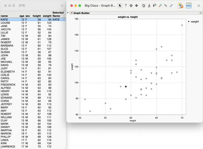

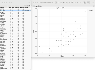

When I select a row in the data table, or from the table box, or by selecting the data point in the Graph Builder, it should show the label in :Selected Name. However, it always seems to be one selected point behind! For example, I select KATIE and the data point is highlighted but there's no label. Then if I select LOUISE, the data point for that row is highlighted, but the data point for KATIE is now labelled!
But if I click LOUISE again, it becomes correctly labelled:
Finally, if I deselect all rows then the last label remains visible.

jthi
Re: Show labels for selected rows only
I think you might have to use something to cause a small delay. One option is row state handler (these can be very unreliable) + run formulas

matth1
Level IV
Thanks for the suggestion! Unfortunately it didn't work for me as is, but the following does:
f = Function({a},
	rr = dt << get selected rows;
	dt << clear select;
	wait(0);
	dt << select rows( rr );
	rs = dt << Make Row State Handler(f);
However, it feels like a horrible workaround. The Make Row State Handler statement inside the function seems to be necessary because after the first call of f() the handler gets forgotten (not sure I understand what's happening here!).
