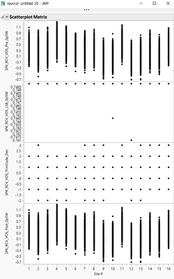

I have a question about adding ref lines to multiple Y in Scatterplot Matrix.
I succeed to get ref line values.
but, I don't know how to add.
I want to know add ScaleBox to every "Y"s.
For exaple,
//sel_colnames = {"SPK_VOS_TrimCode_Dec", "SPK_RCV_VOS_TrimCode_Dec", "SPK_RCV_VOS_Post_0p5W"};
upper_limit = {10, 1, 15, 0.75};
lower_limit = {-10, 0.5, -15, -0.75};
I want to add upper_limit & lower_limit to the below chart.
Also, I want to adjust Y axis scales for each "Y"s.
//JSL for multiple "Y"s - please give me an advice on it.

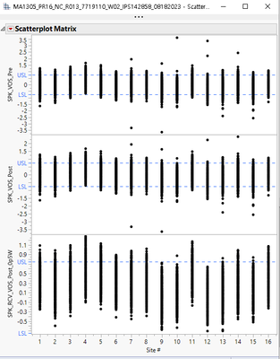

Re: How do I add ref lines to multiple Y in scatterplot Matrix?
At least you will have to abs to abs[x] as currently you are setting all the limits to all axisboxes
Names Default To Here(1);
cols = {"height", "weight"};
lsls = {55, 80};
usls = {70, 160};
spm = dt << Scatterplot Matrix(
	Y(Eval(cols)),
	X(:age),
	Fit Line(0)
abs = Report(spm) << XPath("//AxisBox");
Remove From(abs, N Items(abs)); // Drop x-axis
For (x=1, x <= N Items(abs), x++,
	Eval(EvalExpr(
		abs[x] << Add Ref Line(Expr(lsls[x]), "Dashed", blue, Expr(Char(lsls[x])), 1);
		abs[x] << Add Ref Line(Expr(usls[x]), "Dashed", blue, Expr(Char(usls[x])), 1);
-Jarmo
Here is one simplified example
lsls = {55, 80};
usls = {70, 160};
	Y(Eval(cols)),
	X(:age),
	Fit Line(0)
For Each({ab, idx}, abs,
	Eval(EvalExpr(
		ab << Add Ref Line(Expr(lsls[idx]), "Dashed", blue, "LSL", 1);
		ab << Add Ref Line(Expr(usls[idx]), "Dashed", blue, "USL", 1);
Using Associative Array to store limits might make the code a bit cleaner
-Jarmo
Thank you for your reply.
The example doesn't work in my JMP version 15.
How can I replace "For Each" syntax?
Sorry. I don't know how "For Each" works.
I just replaced For Each syntax with for syntax.
Almost works, but Every 'Y' has the same ref line. (*limit[1] value..)
How can I fix it?
For Each -> For
abs = Report(stm) << XPath("//AxisBox"); //Display Option.
//Show (N Items(abs));
For (x=1, x <= N Items(abs), x++ ,
	Eval(EvalExpr(
		abs << Add Ref Line(Expr(lower_limit[x]), "Dashed", blue, "LSL", 1);
		abs << Add Ref Line(Expr(upper_limit[x]), "Dashed", blue, "USL", 1);
*result
Thanks
lsls = {55, 80};
usls = {70, 160};
	Y(Eval(cols)),
	X(:age),
	Fit Line(0)
	Eval(EvalExpr(
-Jarmo
NagneTE1
Level II
Thanks a lot!!
