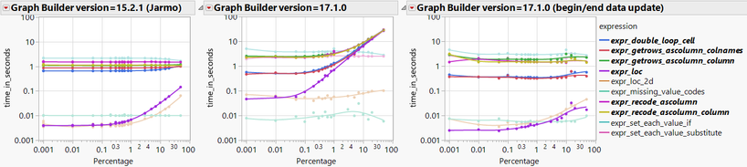

Re: Should you Loop through a data table or use Recode, or use Get Rows Where to change values in a data table
@jthi wrote:
Went maybe a bit too deep on this (but at least got some kind of an idea how to do this type of testing later if I have to).
I wrote a some sort of testing script with different expressions to test different ways of replacing the 999 with missing.
I just used @jthi 's script:
https://community.jmp.com/t5/Discussions/Should-you-Loop-through-a-data-table-or-use-Recode-or-use-G...
to reproduce the performance of the different approaches on a system with Jmp (16.2 & ) 17.1.
I highlighted some approaches (incl. loc) which nowadays have to be inside begin/end data update *)
 to get rid of a severe time increase with increasing percentage fraction of 999s.
Differences by factor 2 could be caused by the different computers.
Who has a system with Jmp 15 and 17 - for a direct comparison?
*) although the subset was opened "invisible".
