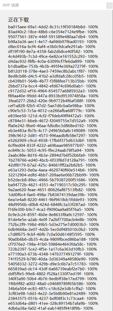

Directly modify to the following form can be.
Only the server that happened to be slow, I thought it was not successful.
