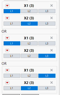

@Jed_Campbell 's solutions could work. You could also do this using Disallowed Combinations in Custom Design. Here is the script for the disallowed combinations for 2 factors, each with 3 levels:
X1 == "L1" & X2 == "L2" | X1 == "L3" & X2 == "L2" | X1 == "L1" & X2 == "L3"
You can specify this with the Disallowed Combinations Filter in Custom Design:
I think that will work but it yields a fairly horrible looking design (attached). I still don't know enough about your experimental objectives to really know, but I have a strong feeling that this way of defining the factors is going to be a problem. I have never seen an example like this. But, again, I don't know enough about what you are trying to achieve.

Okay. Simulating some data and then fitting a model might be a good idea to check it all makes sense. I find that is the best way to be sure when there are unusual constraints on the experiment like this.
