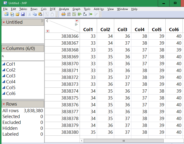

Maybe this:
NChooseK Matrix( 40,6 )
Which makes a Matrix( 3838380, 6 ). You can use
As Table( NChooseK Matrix( 40, 6 ) )
if you want it in a table
lots of rows, six columnslots of rows, six columns
Craige

Re: JMP can generate all possible combinations of 40 numbers in groups of 6 numbers without repetition?
Hi Craig Hales,
Excellent answer!!, I supposed that JMP could do it and I didn't know how, a query......when placing NChooseK Matrix(40,6) as a script...there is no answer.....why?
Cheers,
Marco
Craige_Hales
The function returns a matrix, which you need to assign to a variable, or do something like astable. JMP's behavior when you submit multiple statements is to print the result of the final statement. If you submit just the nchoosekmatrix() then JMP will print it, and immediately forget the matrix.
Craige
