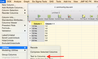

Or if you are using JMP version 12 you could use Text to Columns utilities as follows:
1. Select the column you would like to convert and the select the option under the utilities menu.
2. Put your delimiter in as a space (" "):

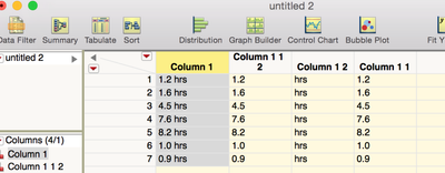

3. This will give you the following output:
