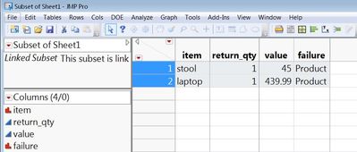

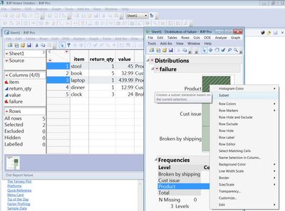

Here is an easy way to do this graphically after you have the full table.  Run Distribution on the Failure Column.  Then highlight, in the graph, the Product bar. Right click and create subset to get a subset that is linked to the original table.  You can save the subset (with a new name is best).9204_Subset_from_Distribution_highlighted_Product_Failure_.JPG
