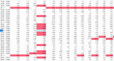

Hello,
After running the outlier analysis tool in JMP, I color coded the cells that contained outliers. How can I select all these cells and replace them with the name, "outlier"? The next step, would be to name all the other cells "normal".
Let me know if this is feasible. A snapshot of the datasheet in appended in this post.

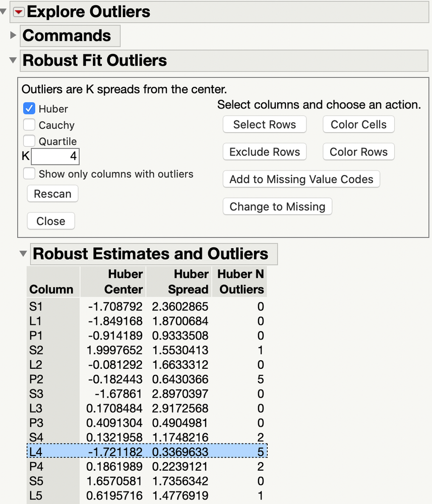

As an alternative to the approach of @txnelson, it's maybe worth going back a step to think about how the table was made. The attached version of the 'Penta' sample data was made exploiting the 'Add To Missing Value Codes' option:
You can then use code like this, which has the added benefit that you are not actually changing the data values in the table:
