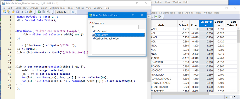

The last script I sent (modified for Current Data Table ) works for both JMP 12 and JMP 13. Here is a screen shot from JMP 12. As the screen shot depicts this is the JMP sample data table.
However, the script will not work if the current data table changes because << Get Selected Columns, returns a list of column references, not the table name.  So :Chloroform will return an error if the current data table does not have that column.  So to make the script more robust, I changed line 18 below to the JSL below.  The script is attached.  It should even if the original table is no longer the current data table. However, if the script (Here) changes the value of dt while the dialog is still open, then a a name collision will occur and cause a problem. Or if the original table is closed when the dialog is still open, problems will occur.
   For(i=1, i<=nitems(_xx), i++, column(dt, char(_xx[i])) << set selected(0));

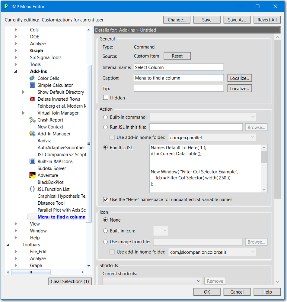

Here is a screenshot, I added the script as an addin. I used this many times while doing other stuff, using it on different tables then using again and it works the same in both JMP 13 and JMP 12.  It is not a version issue.
Thomas1
Level V
Re: Select specific columns with JSL name contains code
You are right. Your code is working. My mistake was the naming of the icon. I did not use a blank.Screenshot2.JPG
After the icon name has been changed to "Column Search" it is working perfectly.
