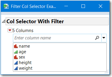

gzmorgan0
Super User (Alumni)
Re: Select specific columns with JSL name contains code
Figured it out:
Names Default To Here( 1 );
New Window( "Filter Col Selector Example",
    fcb = Filter Col Selector( width( 250 ) )
ib = (fcb<<Parent) << Xpath("//IfBox");
ib << set(1);

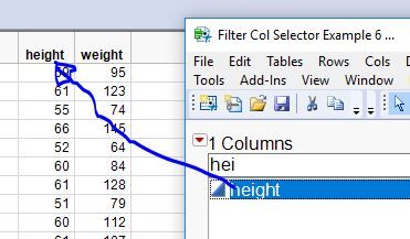

Thomas1
Level V
Thanks for your endurance. I really appreciate it. However the JSL is still not working as intended (see image).
The goal is to get the same function as one gets by using Cols /  Columns Viewer / Name  Contains. The results, which are being shown in the search box, can be clicked and as result, the specific column is selected in the origin data table.
 In case the proper JSL code is available, the whole column search / select process can be carried out much faster.
