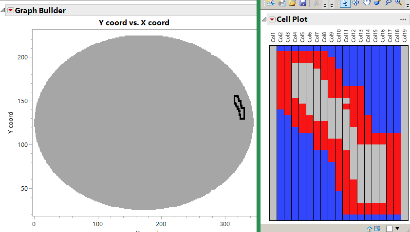

Maybe something like this

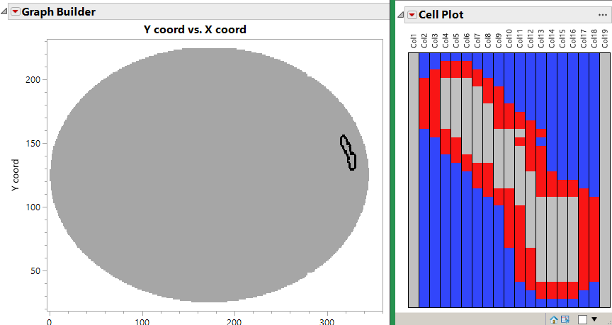

For( r = rowmin, r <= rowmax, r += 1,
	For( c = colmin, c <= colmax, c += 1,
		If( bigpatch[r, c] == unmarked & nearFailure( r, c ),
			bigpatch[r, c] = border// add a border to the bigpatch
// view a cellplot
dtcp = As Table( bigpatch[rowmin - 1 :: rowmax + 1, colmin - 1 :: colmax + 1] );
dtcp[1 :: N Rows( dtcp ), 0] = dtcp[N Rows( dtcp ) :: 1, 0];// flip to make the same as graph builder
dtcp << Cell Plot( Scale Uniformly( 0 ), Center at zero( 0 ), Y( dtcp << getcolumnnames ) );

You might want this
or this, see the commented line for the distance calculation. Depends how you want to treat the diagonal distance.

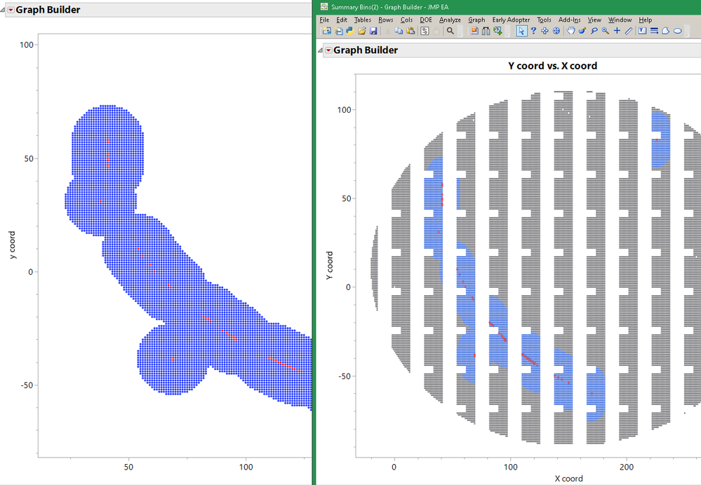

You might try something like this. It is a better approach, I think, but will probably have its own set of problems, so test carefully.
// all new code, all new bugs, check carefully to see if this does what you want
dtt = Open( "/Z:/failures(2).jmp" );
dtS = Open( "/Z:/Summary Bins(2).jmp" );
// the X-Y die coordinates are expected to be integers between -9,999,996 and +9,999,996
encodeLimit = 1e7; // pack/unpack two signed 7-digit integers in one 14-digit number
// a "key" is an X-Y pair packed into a single number. It is called a key
// because it is used as a key in an associative array. These next two
// routines convert between the two representations
keysToXY = Function( {keys},
	{x, y},
	x = Round( keys / encodeLimit );
	y = keys - x * encodeLimit;
	x || y;
XYtoKeys = Function( {xy},
	xy[0, 1] * encodeLimit + xy[0, 2]
// load the X-Y pairs that describe failure positions
failXY = dtt[0, {x coord, y coord}];
// elementary sanity checks
If( Any( failXY <= -encodeLimit + 4 ) | Any( failXY >= encodeLimit - 4 ),
	Throw( "data range" )
If( Any( failXY != Floor( failXY ) ),
	Throw( "integer coords" )
// convert X-Y failure locations to keys, verify they convert back again
failkeys = XYtoKeys( failXY );
If( !All( keysToXY( failkeys ) == failXY ),
	Throw( "encode/decode 1" )
// template for nearby points. THIS TABLE ENCODES THE 2 PIXEL BORDER.
// you might, or might not, want the corners included; the corners are
// commented out because I like the rounded appearance better.
template = [
//-2 -2, // corner
-2 -1,
-2 0,
-2 1,
//-2 2, // corner
-1 -2,
-1 -1,
-1 0,
-1 1,
-1 2,
0 -2,
0 -1,
0 0, // center
0 1,
0 2,
1 -2,
1 -1,
1 0,
1 1,
1 2,
// 2 -2, // corner
2 -1,
2 0,
2 1
//, 2 2 // corner
// convert the template X-Y pairs into keys, verify they convert back again
templatekeys = XYtoKeys( template );
If( !All( keysToXY( templatekeys ) == template ),
	Throw( "encode/decode 2" )
// somthing very cool is going to happen next: template keys will be added to a failure
// key to get a set of keys around the failure key. The template, above, represents a
// square (with rounded corners) about an origin. Adding a failure key moves the
// origin to the X-Y failure point. All the nearby locations are then inserted into a
// collection (associative array) of points that are within 2 of a failure point.
// When done, the actual failure points are removed from the collection, leaving the
// collection as the 2-wide border.
// use AssociativeArray as a set to hold the key values;
// the nearbyPoint set gets populated with both the failure
// points AND the points that are nearby as identified by the template.
nearbyPoints = Associative Array();
For Each( {failkey}, failkeys,
	nearbykeys = failkey + templatekeys; // nearby is the same shape as template, but at failkey, not 0,0
	nearbyPoints << Insert( Associative Array( nearbykeys ) );
// now remove the set of points formed from all the failures...after this,
// nearbypoints is the 2-cell boundary without the interior.
nearbyPoints << Remove( Associative Array( failkeys ) );
// now make a table for a plot. red are from the failures table, blue are the border.
border = keysToXY( Matrix( nearbypoints << getkeys ) ) || J( N Items( nearbypoints ), 1, 1 );
center = failXY || J( N Rows( failXY ), 1, 2 );
dtg = As Table( border |/ center, <<columnnames( {"x coord", "y coord", "highlight"} ) );
dtg << Graph Builder(
	Size( 1493, 888 ),
	Show Control Panel( 0 ),
	Variables( X( :x coord ), Y( :y coord ), Color( :highlight ) ),
	Elements( Points( X, Y, Legend( 8 ) ) ),
	SendToReport( Dispatch( {}, "Graph Builder", FrameBox, {Marker Size( 2 ), Marker Drawing Mode( "Normal" )} ) )
//////////////// check this carefully; I'm not at all sure it does what you want ///////////////
// I don't know what the summary bins represents or why it has the odd cut-out areas.
dtS << deletecolumns( highlight ); // remove the old highlight, replace with new
dtS << Update( With( dtg ), Match Columns( :X coord = :x coord, :Y coord = :y coord ) );
dtS:highlight << Set Modeling Type( "Ordinal" );
dtS << Select Where( :highlight == 1 ) << Markers( "Dot" );
dtS << Select Where( :highlight == 2 ) << Markers( "FilledCircle" );
dtS << clear select;
dtS << Graph Builder(
	Size( 875, 811 ),
	Variables( X( :X coord ), Y( :Y coord ), Color( :highlight ) ),
	Elements( Points( X, Y, Legend( 7 ) ) ),
	SendToReport(
		Dispatch( {}, "X coord", ScaleBox, {Format( "Best", 12 )} ),
		Dispatch( {}, "Y coord", ScaleBox, {Format( "Best", 12 )} ),
		Dispatch( {}, "400", ScaleBox,
			{Legend Model(
				7,
				Properties( -1, {gradient( {Color Theme( "Green to Black to Red" )} )}, Item ID( "highlight", 1 ) ),
				Properties( -1, {Line Color( -58112 ), Fill Color( -58112 )}, Item ID( "Y coord", 1 ) )
		Dispatch( {}, "Graph Builder", FrameBox, {Marker Size( 1 ), Marker Drawing Mode( "Normal" )} )

Craige_Hales
Super User
Re: Select 2 rows from failing die
this might work:
templatesize=15;
templateround = 1; // 0: square corners   1: round corners    2: diamond corners
templatelist = {};
for(x=-templatesize, x<=templatesize, x+=1,
	for(y=-templatesize, y<=templatesize, y+=1,
		if(templateround==0 // use all neighbor points
		| (templateround==1 & round(sqrt(x^2+y^2))<=templatesize) // use neighbors near or inside the circle
		| (templateround==2 & sqrt(x^2+y^2)<=templatesize) // use neighbors inside the circle
			templatelist[nitems(templatelist)+1] = evallist({x,y});
show(templatelist);
template = matrix(templatelist);
//astable(template)<<Graph Builder(
//	Variables( X( :Col2 ), Y( :Col1 ) ),
//	Elements( Points( X, Y, Legend( 3 ) ), Smoother( X, Y, Legend( 4 ) ) )
Craige
