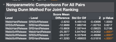

I see, so the z-score is more about magnitude than the sign (+ or -)? The signs were what was confusing me in my situation because I wasn't sure if they were critical to the interpretation of my results. Here is a screenshot of what I'm getting:Screenshot 2024-02-23 at 8.23.40 AM.png
So on the last row, if WebbSoftRelease was in the second column level and SRSHardRelease was in the first column level, would the Z-score be unchanged?

Hi @anzac21   No, the sign would change (but the magnitude would be the same). It will always be the same sign as the score mean difference. It is calculated as (score mean difference)/(std err diff).
