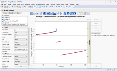

You get an output that looks something like this.

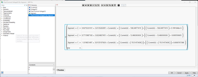

  If you use the Segment column as a BY variable in the SLS model fit, when you get your model of the data, you can then hold down the CTRL key and left click the red hot button near one of the "Response Voltage" names and select Save Columns > Prediction Formula, and this will save a prediction formula column to the data table where a different equation is used, depending on the segment number.

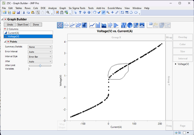

  Another way you could do it is by making your graph of the voltage vs current in graph builder, then using the lasso tool (next to the magnifying glass, under the menus) to select the the data you want to fit.
  Then go Rows > Row Selection > Invert Row Selection.
  Then right click on one of the row numbers and select Hide and Exclude. Then, when you go to the Model platform for your standard least squares, you can model just those data points that aren't hidden and excluded.
  In the below example, you can see the model and the SLS fit to the data. From the Residual by Predicted Plot, you can see some curvature, so I added a Current*Current term, and you get a much better fit with slightly more random residuals.
