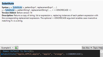

Re: Searching and counting substrings within a text field
Substitute does allow you to use << IGNORECASE
Names Default To Here(1);
Substitute("Apple,APPLE,apple", "apple", "orange", <<IGNORECASE);
https://www.jmp.com/support/help/en/17.0/#page/jmp/list-functions.shtml?os=win&source=application#ww...
