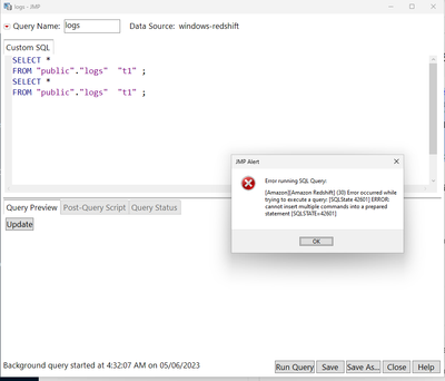

dear members of the forum,
when using jmp to query amazon redshift i need to send two statements together but for some reason this i get an error saying:
unfortunately, my query is very elaborate and doesn't work with just a "Where" statement for each separate table.
if anyone has any idea how to overcome this issue it would be helpful.
Thanks

i get the same error if i try it using the following script:

Generally you can't execute two SQL statements with one call to EXECUTE SQL.  Both statements are the same; perhaps you were just showing an example?
Why are you trying to run two SQL statements at once?  EXECUTE SQL returns a dataset for each SQL statement.
Why not just run two EXECUTE SQL commands?

you are right @pmroz , it was just an example of two statements.
sometimes i need two statements to create a sub-sample (temporary table) or define a function.
in most cases i manage to use the "With" statement instead of a temporary table but not always. especially when using the "With" statements requires very complex sub-queries that are not allowed.   .

thank you very much @pmroz
splitting the two statements into separate Execute SQL statements works perfect.
