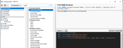

The answer to your question comes from the Scripting Indes
Here is one of the examples from that entry
Names Default To Here( 1 );
Open( "$SAMPLE_DATA/Big Class.jmp" );
Open( "$SAMPLE_DATA/Abrasion.jmp" );
Create Excel Workbook(
	"$TEMP/MyWorkbook.xlsx",
	{"Big Class", "Abrasion"},
	{"Big", "Abrasive"}
	{"Big", "Abrasive"}
Jim

Thank you for pointing out the Srcipting index, it is really helpful.
A further question: does the "list of the worksheet names" have to be strings? Can they be string variables?
