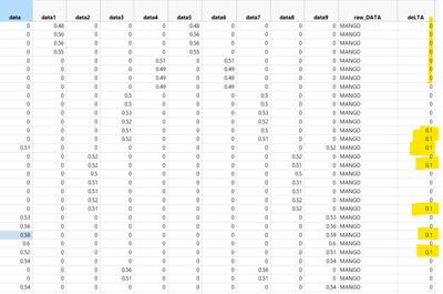

Need help to  develop one script to do subtraction of multiple column , column name and count is variable,
can change based on analysis,
Need to populate column delta with differences all the value from same row,
sample data as below
expected output:

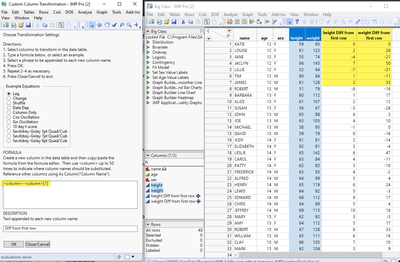

Can you give an example of the formula you want to use?  This sounds like something I would use the custom transformation in theScripting Tools add-in for.

Re: Subtraction of multiple column
Expected output in delta as below,

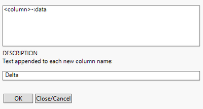

Now I see, in that case I would personally use the custom transformation function in theScripting Tools add-in.  I would select all of the columns you want to transform (I think data1-data10) and then select Custom Transformation from the Cols menu (available after installing the add-in) and enter these settings:
