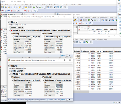

  Here's the output I got from running a modified version of your script:
  Here's the modified script:

  Running the below script on your data table, I get the following output:
Names Default To Here( 1 ); //keeps variables local, not global

I’ve tried your script. It runs well but not exactly as I wish. It seems like the script extracts data from all locations to create a subset, and then runs the neural. I tested it with a subset of 02 locations. The neural ran twice. However, their reports are the same. So I think the For Loop has some issues. Could you please help me ? I attached my script and data in this discussion in case you need to use.
Thanks
G_M
G_M
Level III
Re: Automate the neural network
I believe that the issue is that you need to add the Char function around the :ID in the Select Where function.
Select Where(loc[j] == Char(:ID))
