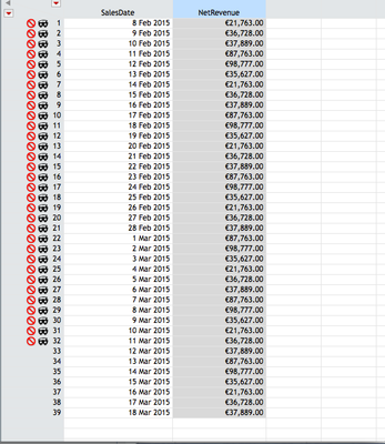

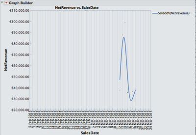

saitcopuroglu
Level IV
Re: Script for dynamic date/time axising
Thank you.
Even the Data is not displayed, the time axis still displays the hidden/excluded rows.
I actually need both not to be displayed. Does the same script go for the x axis display?
Graph Builder usually adapts the axes automatically to show the range of included data only. Are you sure you haven't hard coded the x-axis limits? Check the graph builder script.
The  Min( 3505939200 ), Max( 3510000000 ) forces the axis to hose limits. Try to delete the entire Send to report(...) part.
Or change it into something like:
Min(today()-in days(7)), Max(today())
saitcopuroglu
Level IV
Deleting the entire Send To( did not but rewriting the min-max helped.
Thank you a lot!
