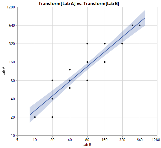

Thanks for coming to my aid again, and thanks very much for your solution, its brillant, a couple of problems i have in getting the presentation l am after, and i dont know if its possible. Unfortunately l am still stuck with JMP 14 and dont have the custom area in axis setting's.trial.png
l can't get the y axis to start at 5, i have tried including the Min () and Max() into the script but to no avail

Hi gzmorgan0,
l completely forgot about the grabber, the 30 in my syntax must have been a leftover from somethings l was trying, have fixed both graphs now and am very gratefull for your help, interestingly when i use the pull down menu's for graph bulider l dont get the custom button, but when i run the syntax and click on the axis for axis settings l can see the box.
