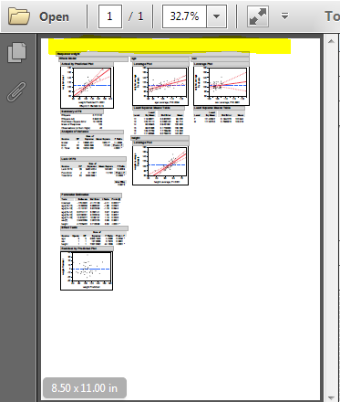

There is a better way that also works in JMP 10:
journal << set Print Headers( "", "", "" );
journal << save pdf( "$temp\test.pdf" );
removing the print headers (and footers if necessary) makes the PDF page look a lot better.
PDF without JMP headersPDF without JMP headers
Craige
nacka
Level II
Re: Scaling to fit to page width
This is beautiful! Thank you!
