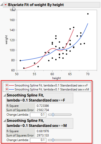

How do I delete Smoothing spline controls? I have a report with bunch of splines and this list of controls takes the whole page effectively collapsing the chart. I only need splines for visual guide, I don't care about the numbers. How do I remove it?

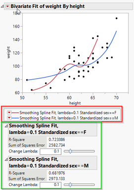

Anyways, couple of questions - For me collapsing IfBoxes collapses pretty much everything - window is empty. This is because I have other IfBoxes on the plot.
If I only use
XPath("//BorderBox")
it will take care of the boxes in red frame:
Boxes in green frame that are controlling the splines below - those stay.
I can solve it by saying Report View ("Summary") when building the plot, so all in all it works, but I'm still wondering - how would I isolate those IfBoxes - Can I say something like
Xpath("//OutlineBox/IfBox")
(this one didn't work).

I can make it work by uncommenting "Report View", but I also would like to understand how to do that using XPath (commented line at the end results in empty window).

I figured why it wasn't working in my case and was working in yours - parenthesis.

One more thing came to my mind related to IfBox is that they do have special property. You can set the "if value" to 0 or 1, so it might be better idea than setting visibility to "Collapse". You could test by replacing the
(rbiv << Xpath("//IfBox"))<< Visibility("Collapse");
with
(rbiv << Xpath("//IfBox"))<< Set(0);
-Jarmo
