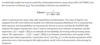

Hi- need to fit the following logistic model to data, where Y=binary (1=diseased, 0=no-disease) and X is continuous. The model is similar to a logistic but with an added parameter, lambda. Any advice on how to proceed in JMP will be appreciated.

Hi @vincem : That is the Logistic 3p model in the Nonlinear platform Model Library, where lambda (your model) = theta1, alpha ( your model) = ln(theta2), beta (your model) = theta3.

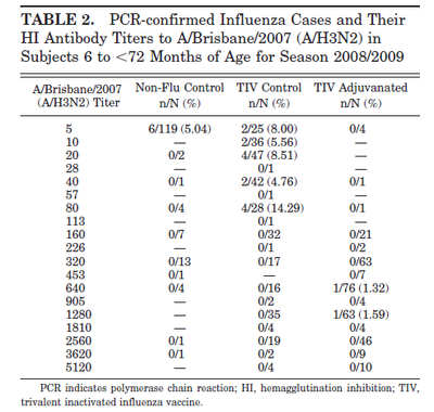

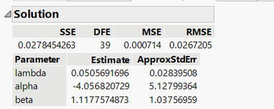

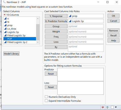

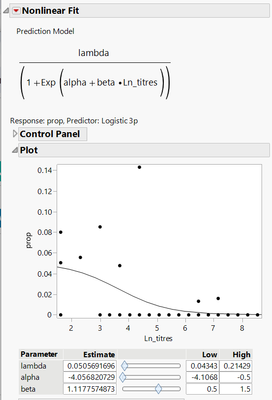

Thanks again..I have fitted  the nonlinear model and fitted the below, where prop=n/N in below table. Parameter estimates noted below. i think its worked as its should..
Data is from the publication
https://pubmed.ncbi.nlm.nih.gov/21983214/
