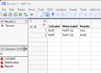

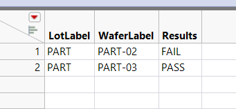

Hello,
Attached is the data table of 2 PARTS namely PART-02 and PART-03. Each part has it's own columns and rows (ColX, RowY). I wish to use JSL to identify the PART which has consecutive columns or rows appearing more than 4. Here PART-02 is the one that has rows appearing more than 4 times consecutively. I want my output to be just a table with PART ID and the result like below.

Here is the JSL that I came up with that creates the new table and populates it as you specified

Hi Jim, in the previous dataset, for PART-01, 02 should be pass. Sorry for the misinformation. Attached is a larger dataset including PART-01,02,03,17. Part-01,02,03 should be Pass and only PART-17 should fail.  It should  be  as below but your script is stating PART02,03 are failing as well.

Yes, you need to change the 4 to 7 and the -3 to -6.
The weighting factor provides the ability to set weight of each of the values being average.  The value of 1 indicates to use equal weighting on each value.
Before = sets the number of rows before  the current row to use in the calculation of the moving average.
After = sets the number of rows after the current row to use in the calculation of the moving average.
