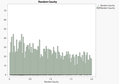

However, let's suppose my observations are truncated to the range (0,2). So, I am seeing only a relatively limited view of data. I generated some Cauchy (0,2) random variates and truncated the data table to show only those between 0 and 2:
Is there any way to fit this data to a Cauchy (0, gamma) to get a best estimate of gamma? More generally, does JMP support fitting truncated data?

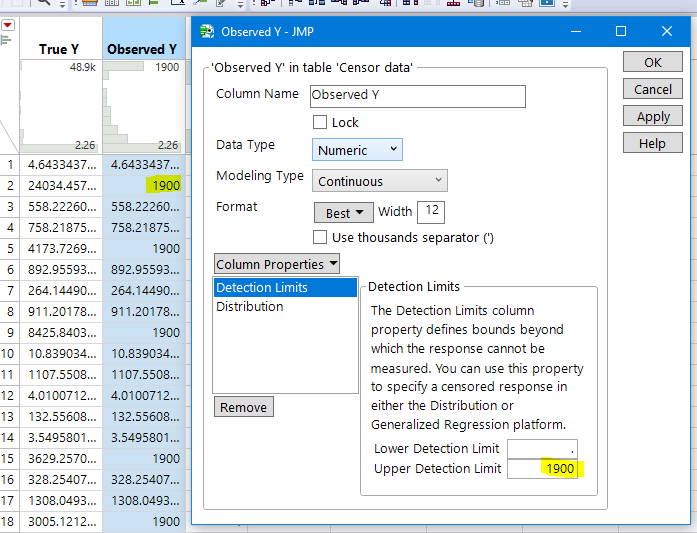

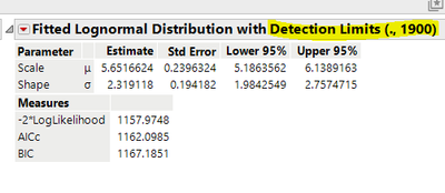

Not sure if this is what you mean but I think you talk about censored data. JMP must know how many datapoints are cut in order to make a better estimation. By adding the column property "Detection Limits" you can tell JMP that this data was cut:

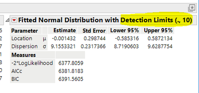

When you then fit your distribution, it can estimate the values better based on this information:
The problem at the moment is, that if you pre-select a distribution, this does not seems to work. You must fit a new distribution within the platform.

Thanks for the response, but my data are not censored. In your example, you have a known number of observations that are greater than or equal to some value (in your case, 1900). That's not my situation.
In my example, I do not know how many exceeded 2. I only have observations lying between 0 and 2, with no knowledge of how many observations were outside that range (because my data collection mechanism can not capture them or even know of them). So I do not have a bunch of censored observations.

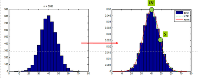

This is the idea behind it:

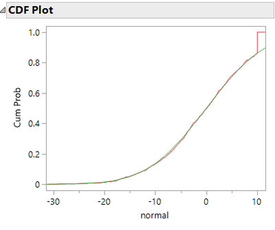

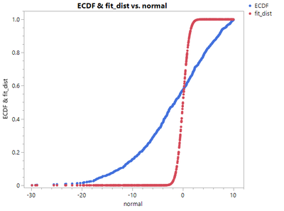

I first fit a normal distribution with on additional censored data point and sum up all differences with the ECDF:
Then I iterate through all additional censored datapoints, fit the normal distribution again until I get to the last one:
this ist the sum of absolute difference over the additional points:

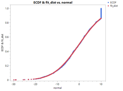

The lowest point now gives me the estimation of how many points are missing:
This then gives me a "best" fit for the distribution:

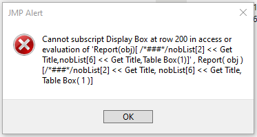

And when I run your script, I get the following error. The data set for the first plot is generated, but the second data set has 200 rows and is full of missing values.

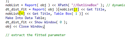

The script within the Cut_Normal should work but JMP may have some problems with language or pe-sets.
I work with the English JMP 18.0.1 version and I may have some other Preferences (like I have my plots always stacked).
I did not search for the Display Box with a fix value since the censor limit is in the title. Maybe you can search for the title when you know how JMP will pars it in the title:
So those two numbers can be different in your JMP:

 @GregChesterton has only part of the curve so I fit different number of missing values and compare how well the estimation fits with the data that are there.
this is the best fit (least sum deviation) from the normal data set:

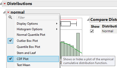

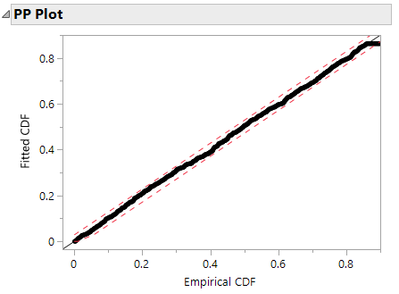

In JMP you can have also a look at the PP Plot under the fit witch is the direct comparison.

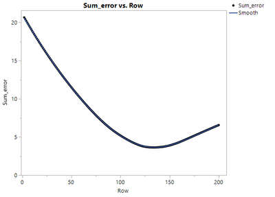

I iterate through possible missing values and write down the sum difference between ECDF and the fitted CDF of the probability function.
Its "brute force" and not very elegant but gives a OK result.
An other possible option is to make a simple numerical optimizer with the ECDF tail and the function with the sum difference as its target and then minimize it.

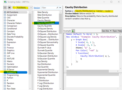

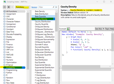

On the numerator, it is the Cauch(0, gamma) density function, in your case. Find it in the JMP scripting index:
On the denominator, F function is the Cauchy(0, gamma) distribution, in your case. Find it in the index:
Now you need to piece the information to create a negative log-likelihood loss function formula column.
