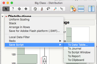

As for your specific question, for any report you generate you can save the script to reproduce back to the data table. Just go to the red triangle menu at the top of the report and choose Script->Save To Data Table...
That will add the script to your data table. You'll find it in the upper left corner. Click on the green "play" button to run the script and reproduce the report.
Scripts in JMP data tableScripts in JMP data table
