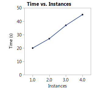

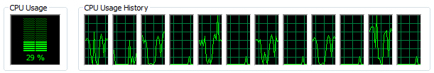

This property of JMP bothers me, thus I spent some time testing my theory that JMP only uses a fraction of the total cores. Here are results when concurrently running 1, 2, 3, or 4 copies of the script below each in their own instance of JMP.
One Instance
19-21 seconds

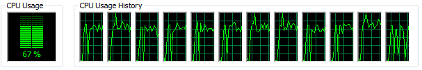

Two Instances
26-28 seconds
Three Instances
34-39 seconds

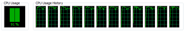

Four Instances
43-47 seconds
The time to run two copies at once is certainly less than the time to run one twice:

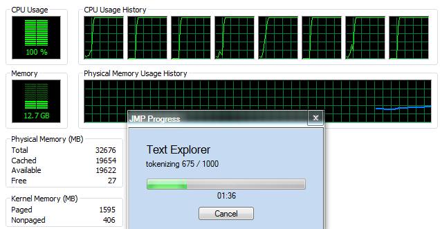

How well JMP uses the available processors depends on which analysis platform is running and the data being processed. Here's JMP running Text Explorer during the text parsing phase, on long documents, with number of rows > number of processors. (Other platforms will behave differently and some will not be able to take advantage of threading. Text Explorer's parsing is something I've worked with recently.)
100% busy100% busy
Text Explorer's algorithms are not always able to keep the machine 100% busy. Some work depends on other work being completed first, and some work that is threaded competes for resources (like memory access) in a way that makes threads wait.

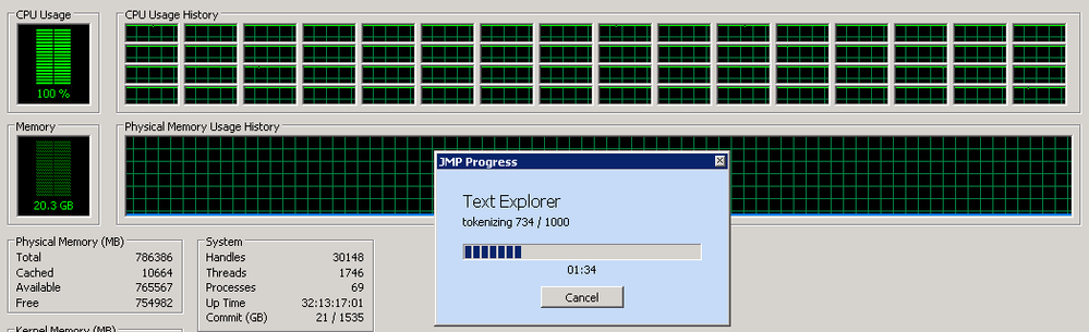

Adding more CPUs has a limit; here all 32/64 CPUs look busy but the work is proceeding at about the same rate:
100% busy but not making progress much faster100% busy but not making progress much faster
I suspect these CPUs are getting in each other's way. A GB of documents moving through memory has a lot of opportunity to churn the cache memory in the CPUs. Mostly JMP is developed on machines with 4 to 12 CPUs and that's likely to be what the algorithms are tuned for. For example, after Text Explorer finishes the parsing step, it combines the parsing results using half of the processors because we determined that was faster than using all of them...on an 8 CPU machine.
So, yes, 4-12 CPUs, faster CPUs, and enough memory to avoid paging. If you don't have enough memory to hold the data without paging to disk, nothing else will help.
