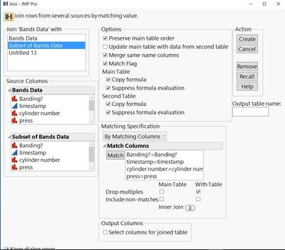

Re: Merging two tables using several columns
Using Tables > Join you can use matching columns to join your tables.  For POC I used Bands Data.jmp from the sample data and subset a portion of the data out and then deleted the columns I wanted to add back from the original table.  See the set up dialog below as a guide on how to set up the join.  If you are joining more than two tables together then I would suggest using JMP Query Builder also found under the Tables drop down.
