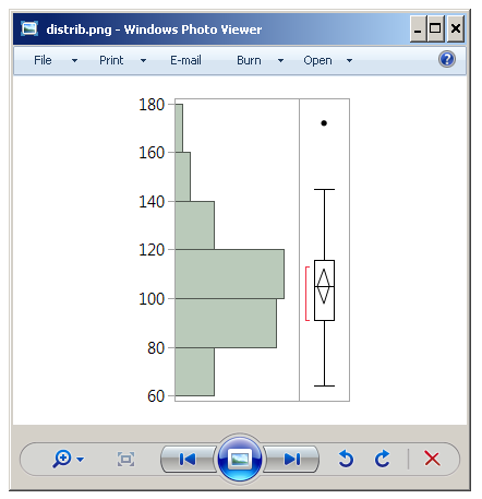

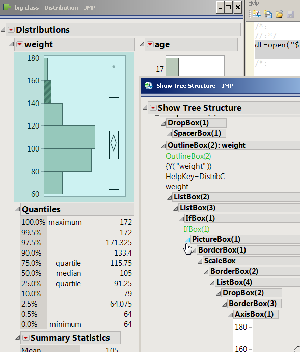

Yes. @Wendy_Murphrey  just posted an xpath way to navigate to a node in the display box tree, or you can use the display box subscripting. When you get to the right node, save it as a PNG. Something like this using display box subscripts.
from the top left red triangle in the report, Edit->Show Tree Structurefrom the top left red triangle in the report, Edit->Show Tree Structure
Use the show tree structure command to identify the part of the report you need. Here, picture box(1) captures the graph without the title for the entire section. Then, use JSL like this:
dt = Open( "$sample_data/big class.jmp" );
dist = dt << Distribution(
	Continuous Distribution( Column( :weight ) ),
	Nominal Distribution( Column( :age ) )
boxtree = Report( dist );
picbox = boxtree[Picture Box( 1 )];
picbox << savepicture( "$desktop/distrib.png", "png" );
The captured PNG fileThe captured PNG file

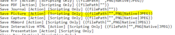

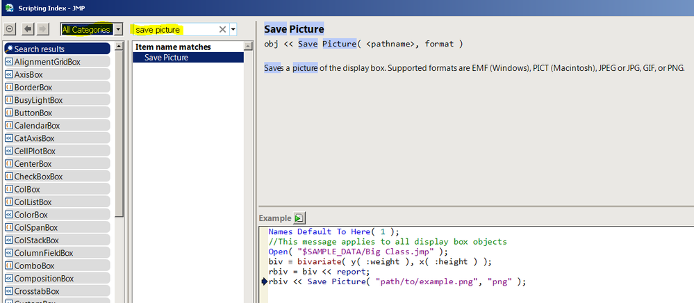

At the point when I had the picbox variable set, I was not sure what the command was to take a picture. I used this to find out what commands were available for that box:
showproperties(picbox)
and found this in the list:
save picture commandsave picture command
which you can then look up in the scripting index:
Help->Scripting IndexHelp->Scripting Index

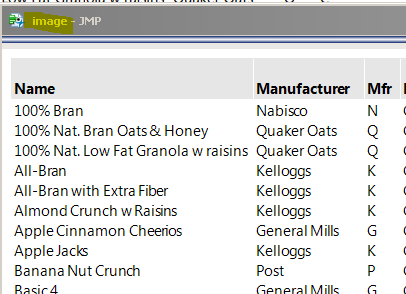

Craige_Hales
Re: Saving Journal as PNG (or PDF)
Sorry, I missed the data table bit. Data tables don't act like analysis platforms when trying to take pictures of their display boxes. Here's another approach, using a journal box.
dt = Open( "$sample_data/Cereal.jmp" );
journaltext = (Window( dt )) << getjournal;
journalbox = Journal Box( journaltext );
image = journalbox << getpicture;
New Window( "image", image );
pdf = journalbox << savepdf( "$temp/cereal.pdf" );
Open( "$temp/cereal.pdf" );
image capture of tableimage capture of table
You can save an image with
journalbox << savepicture( "$temp/cereal.png", "png" );
Craige
