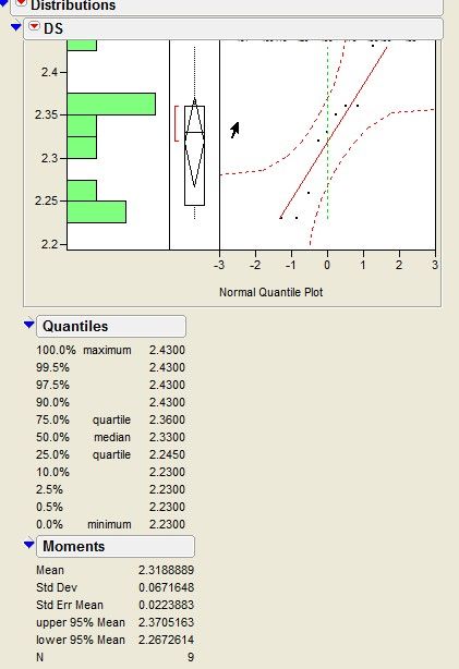

Sorry, but i thought the script was built in your jmp version, so when I check in my jmp version i didnt see the outlier test function so I assume that my version does not have it. I'm stil new with the JSL capability.
Here is the screenshot of my data but I dont see the Dixon outlier test summary statistic in my plot, any reason for this?Is it because it indicates that there are no outliers from my distribution

Re: Samples required to determine Normal Distribution Plot
Download the script from the link I gave you. Open your data table. Open the script. Run the script. (Various ways: Select Edit > Run Script, press Ctrl-R (Windows) or Cmd-R (Macintosh), click the Run Script button in the toolbar, or right-click in the script editor and select Run Script.l) Now you should be able to follow the instructions provided in the links to select the data column for analysis and proceed.

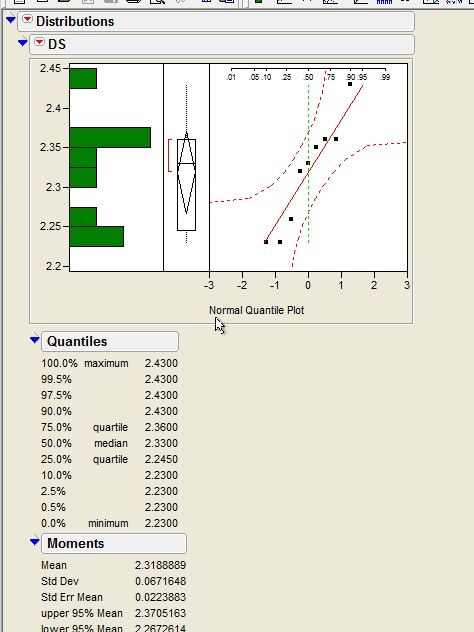

I have tried you suggestion and able to run the script as what you show in the example.
But when i run the analysis, my distribution plot does not show the outlier analysis, is it because there are no outliers?
You have not done anything wrong. The Dixon test results should appear regardless of the presence of an outlier. The portion of the script that adds a custom report for the outlier analysis to the Distribution platform is (apparently) incompatible with JMP 5. I don't have this old version of JMP so I can neither confirm this conclusion nor determine a work-around. JMP 5 is about fifteen years old.
