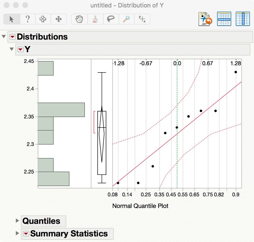

What did you use for your "rough estimate?" Why do you think that there are two populations in this sample of data?
The normal quantile plot does not indicate two populations. That is, a model based on a single normal distribution appears adequate:

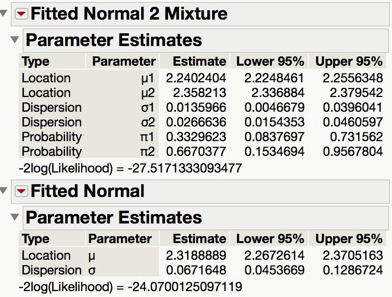

You could fit a mixture model based on two normal distributions:
The better model is the one with the smallest -2L. AICc is a better criterion because it includes a penalty for over-fitting. AICc is computed as -2L + 2k +2k(k+1)/(n-k-1) where k is the number of parameters and n is the sample size. The AICc for the normal distribution model is -24.0700125097119 + 2(2) + 2(2)(2+1)/(9-2-1) = −18.0700125097. The AICc for the normal mixtures distribution model is -24.0700125097119 + 2(6) + 2(6)(2+1)/(9-6-1) = 5.9299874903.
So a naive comparison based on -2L would select the normal mixtures model, the penalized criterion easily selects the simpler normal distribution.
The normal quantile plot shows no indication of a statistical outlier. If you know the contamination process, then a selective outlier detection test may be applied. Otherwise, you would have to use a general outlier test. Such a test would not be significant in this case.

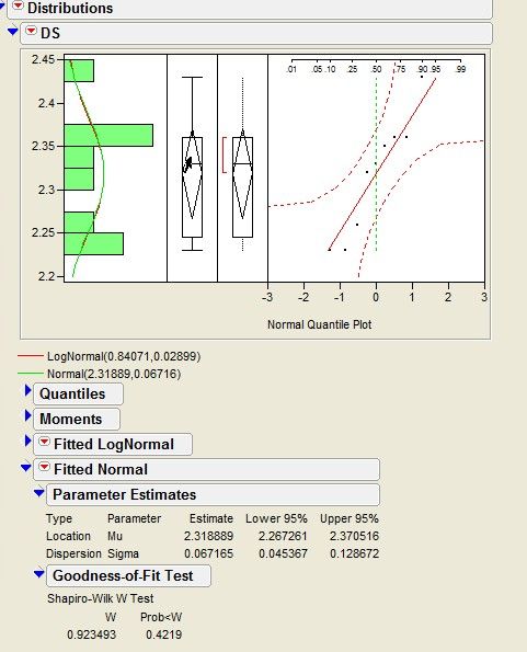

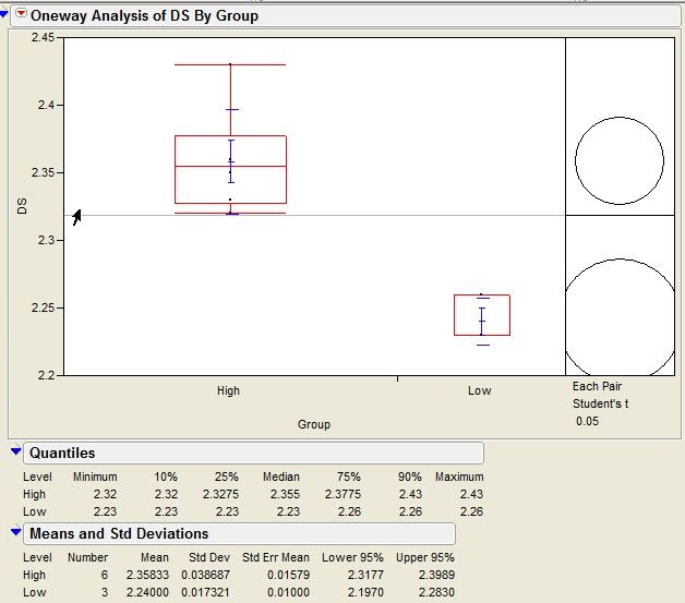

thanks again for the reply, here is how i compare the two group of DS, basically I have group the ~2.2 into one group while the one above ~2.3 in another group and perform the t-test to compare the mean. From the t-test is shows that the two are from two different population.
Here is my quantile plot, based on the shapiro wilk test can I say that the population of my sample is from a normal distribution.
Based on the normal quantile plot can I say that the 2.2 is coming from the same population as the rest?This is the question that I need to answer
THank you in advance for your explanation

The analysis of the 9 observations with the normal quantile plot to determine if an extreme value is an outlier is invalid if you have already determined that there are two populations with respect to the mean parameter. You can't use a mixed sample this way for a valid conclusion. You must evaluate the potential outlier against only the observations in the sample from the same population (sample size is 3).
Funny that your goodness of fit test does not reject the single normal distribution model but your t-test did reject that the two groups have the same mean.
Anyway, you must not analyze the distribution of the 9 observations as a single population now that you established that there are two populations. You should separately examine the normal quantile plot for each population. You can use the Group column in the By analysis role in the Distribution launch dialog.
What is the basis for assignment of an observation to Group = Low or Group = High?

Thanks for the fast response, i guess my original question to the problem is whether the 2.2 value is coming from the same population as the 2.3, i actually segregrate the two groups based on my assumption that they belong to a different group. What is the correct way to approach this problem, can i say that they belong to the same normal distribution ?
Re: Samples required to determine Normal Distribution Plot
Are you asking if a single value (2.2) is coming from the same population? Then follow my last suggestion of using the normal quantile plot with the DS=Low observations.
Are you asking if the group of Group=Low observations come from the same population as the rest (Group=High)? Then use the t-test result.
