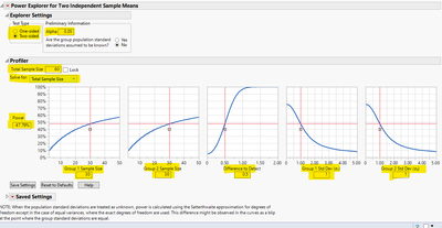

I would like to access and edit different components/fields(text fields) of sample size explorer programmatically. I want to build a custom script where my user interface(much simple with some default values) will ask user similar numbers/options to enter. that user interface should connect to sample size explorer platform and return me outputs. How can I do that. below are highlighted components I want access to edit

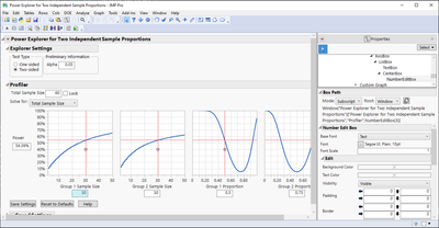

And if you just wish to modify those values, find the reference to the window and then references to those number edit boxes. To get the access to the window, you can use Window("windowname") or maybe try to access the window directly using reference you might find from the builtin jsl. Then use Show Properties to explore which display elements you wish to access

Without knowing how you are going to be building your script, this example gives some suggestions on how to access the values (there might be better ways which you can find potentially find from the builtin scripts)
Names Default To Here(1);
path = "$BUILTIN_SCRIPTS/Power_Two_Independent_Sample_Means.jsl";
Include(path);
show(win << Get Window Title); // take a look at Power_Two_Independent_Sample_Means.jsl and you see this reference is there
// Using indexing from Show Properties
// Window("Power Explorer for Two Independent Sample Means")["Power Explorer for Two Independent Sample Means","Explorer Settings",NumberEditBox(1)]
aneb1 = win[Outline Box("Explorer Settings"), NumberEditBox(1)];
// Using references
// _alphanb gets lost somewhere, so access through alphatb
alpha_neb2 = (alphatb << sib);
// Using XPath
alpha_neb = win << XPath("//TextBox[text() ='Alpha']/following-sibling::NumberEditBox");
alpha_neb3 = alpha_neb[1]; // XPath returns a list
// Setting the values
alpha_neb2 << Set(0.10, run script(1)); // You most likely want to include Run Script(1) to most value changes to avoid messing anything up
-Jarmo
