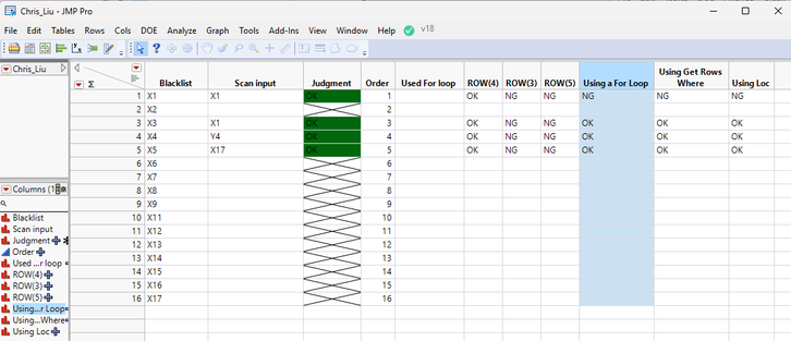

   As the attachments show, the formula of column ROW(3) is effective but just for one row.
   The formula of column "Used For loop " as below color shows, I know that formulas can't contain For loops, so remove the For loop parts and change ":Scan input[i]" to other expressions or other functions to Implement from ": Scan input[1]" to": Scan input[end row number]", then automatically updated based on each row of the "Scan input" column. Please help to correct it, thanks!
For(i = 1, i <= N Rows(), i++,
	If(Is Missing(:Scan input),
		If(Col Sum(:Blacklist == :Scan input[i]) > 0,
			"NG",
			"OK"

Thanks! However, the correct result on rows 3 and 5 should show NG. It hasn't been solved yet.

The formulas that I provided all look at the value of Black List for a given row, and then look through all of the rows for Scan Input to see if there is any row that has the same value.
I must have misinterpreted what you are trying to do.  I thought that was what your supplied JSL was trying to do.  Can you describe what your desired results are?

The results of all Blacklist columns are NG. The actual scenario is that the products produced by a fixture are already known to be NG. They need to be found out and scanned into the Scan input column with a barcode gun, and NG will be displayed as long as the value of the "Scan input" column is in any row of the Blacklist column. For example, row 1 is exactly equal so it shows NG, and row 3 is not exactly equal, but "X1" appears in row 1 of the Blacklist column, so need shows NG.
