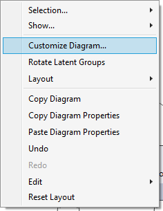

@i2-k , you can also access the "Customize Diagram" menu using the Diagram settings button:
As @jthi indicated, you can select Latent in the dropdown menu under Variable Appearance and then customize the width and height.
