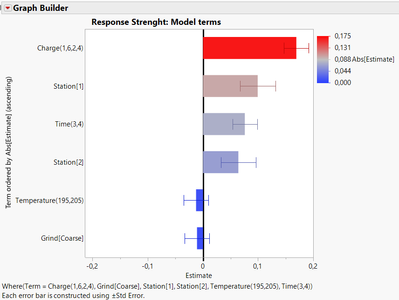

I frequently use this functionality to create visualizations about terms included in the model and their relative importance/size with the table generated (here with the "Parameter Estimates" table) and Graph Builder (with or without the intercept using Local Data Filter):
It can also help visualize different models performances and may help models comparisons and selection.
