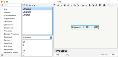

Then Cols->New Columns... to add a new column and give it a formula using the Sequence() function.
Temp columnTemp column

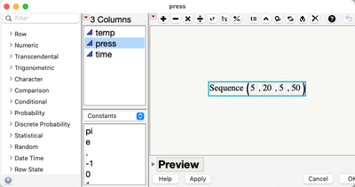

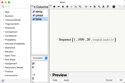

I'd do the same for the other columns.
press columnpress column
time columntime column

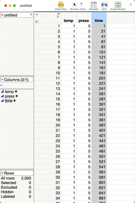

After adding rows to the data table you'll end up with this:

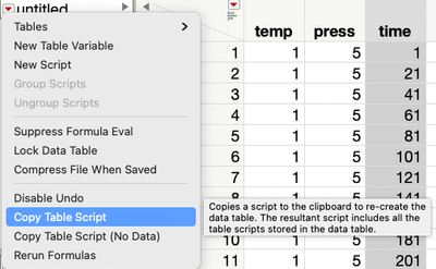

When you're ready you can go to the red triangle next to the data table's name and Copy Table Script.
That will give you the following script to create a New Table:
