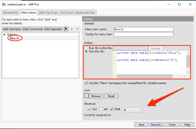

For this use case, you can create a JMP Add-in to run your JSL on the selected rows and assign a keyboard shortcut for it.
Imagine that you have this JSL which colors and marks the selected rows of the current data table blue X.
current data table()<<colors("Blue");
current data table()<<Markers("X");
You can use File->New Add-in to create a new add-in.
In the Add-in Builder window you can assign a shortcut key to menu command that you create for the add-in.
After saving and installing this add-in, whenever I hit Ctrl-Shift-B I'll color and mark the selected rows of the current data table with a blue X.
Of course my script could do much more if I'm willing to make some assumptions about when I might use it (e.g., only when I've got data tables of a certain structure, or only when I am looking at a particular platform).
-Jeff
-Jeff
