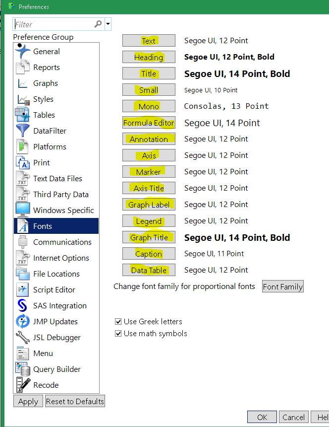

The base font names are found in preferences:
The user can set their own preference for each base font.The user can set their own preference for each base font.

Using the Base Font Names is good because it keeps the OS dependency out of your JSL and allows users to customize the way fonts are used. Try to pick a Base Font name that represents what the font is doing for your application.
