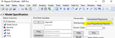

In addition, if you have JMP Pro, Generalized Regression platform support Cox Proportional Hazards with advanced variable selection techniques.
Generalized Regression Documentation
