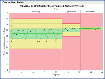

I did a short presentation using sequential DoE for the fine-tuning of an algorithm (Random Forest) on a fixed dataset, using screening design, then optimization design, and finally using a simple factorial screening design to assess robustness of the factors range found previously : https://www.linkedin.com/posts/victorguiller_design-of-experiments-machine-learning-activity-7122469...

The situation you described is similar to what I have done on the example mentioned earlier :
This sequential methodology is of course possible in JMP. You can do it in 2 steps :
  1. Identify the factors and their restricted ranges that match your specifications thanks to the previous optimization response surface design (and model) done and the Design Space Profiler.
  2. Once the factors and ranges are identified, you can Augment Designs (and add a block for the new set of runs to better differentiate the results from the original DoE and the new experiments) or create a new Custom design with the factors and range identified earlier, and check that the results from your second set of experiments is in accordance with your response mean and variance acceptability specifications :
Hope this complementary answer will help you,
Victor GUILLER
